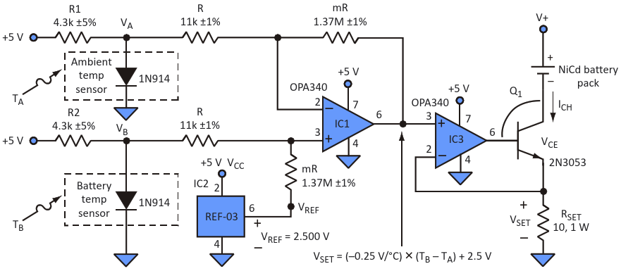

The voltage outputs of the temperature-sensing diodes are applied to a standard difference amplifier, which in turn outputs the difference voltage that will vary from -20 V to 0 V as the difference temperature rises from 0°C to 10 °C
AuthorsJoseph Diecidue
Main DocumentArticle ««Intelligent» NiCd Charger Avoids Battery Damage From High Currents»
DescriptionFigure 2
File Format / SizePDF / 40 Kb
