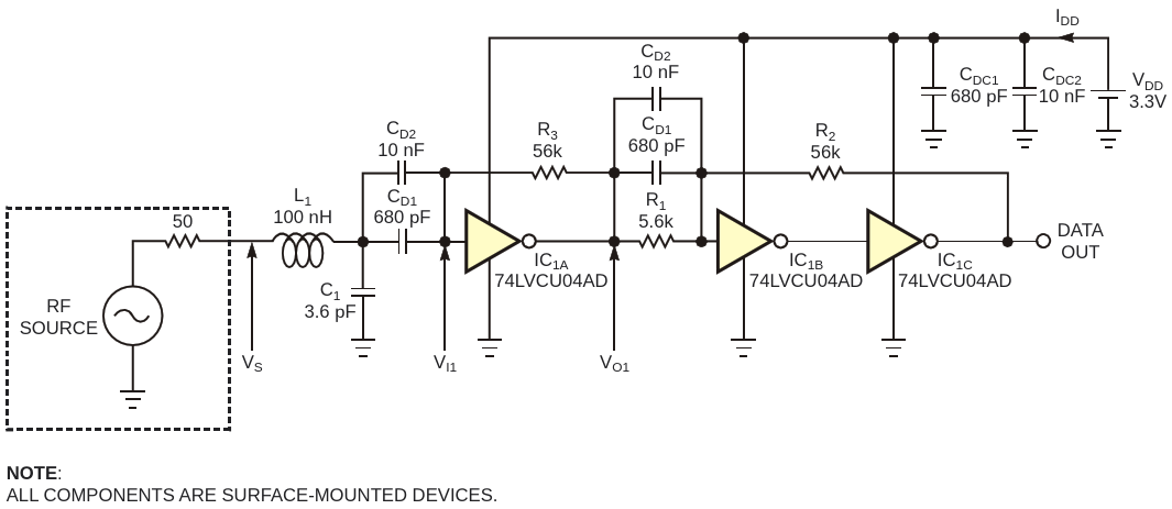

Three high-speed CMOS inverters …
Three high-speed CMOS inverters and a few passive components form an RF-to-logic converter

CMOS inverters convert RF to digital signal
Figure 1
25 Kb
Figure 1. Three high-speed CMOS inverters and a few passive components form an RF-to-logic converter
Figure 3. An input-level-versus-frequency plot of the RF-to-digital comparator measured from the RF source's reference plane to a clean logic output reveals less-than-100-mV sensitivity at 160 MHz and usable output to 200 MHz
