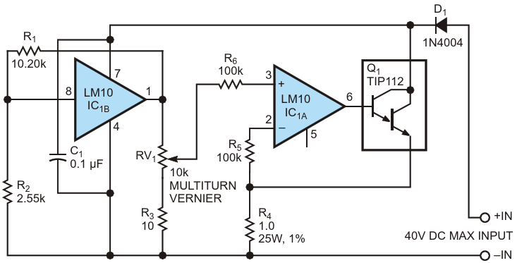

A handful of inexpensive parts builds a precision current sink that provides 1-mA to 1 A sink current over a wide compliance-voltage range

Figure 1. A handful of inexpensive parts builds a precision current sink that provides 1-mA to 1 A sink current over a wide compliance-voltage range
Figure 2. For compliance voltages above 4.9 V, the circuit in Figure 1 provides a rock-solid 1 A sink current, with less than 0.03% variation with voltage
