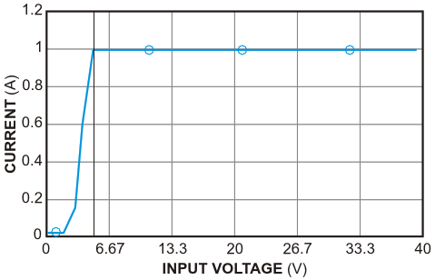

For compliance voltages above 4.9 V, the circuit in Figure 1 provides a rock-solid 1 A sink current, with less than 0.03% variation with voltage

Figure 2. For compliance voltages above 4.9 V, the circuit in Figure 1 provides a rock-solid 1 A sink current, with less than 0.03% variation with voltage
