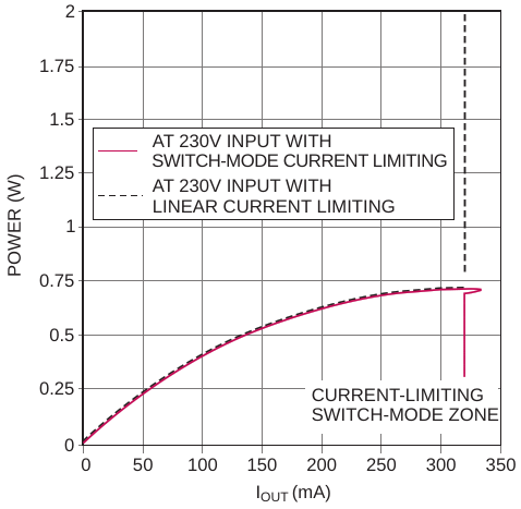

Figure 2. Without switch-mode current limiting, the circuit of Figure 1 can crash and burn

Figure 4. Switch-mode current limiting restricts current in Figure 3's circuit to about 320 mA
