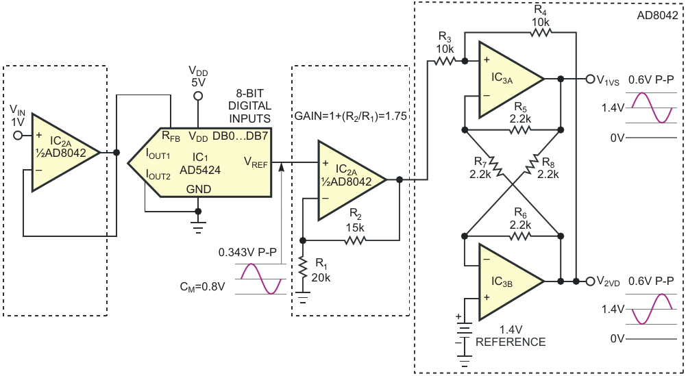

In this configuration, a …
In this configuration, a positive reference voltage produces a positive output voltage

Circuit converts DAC's outputs from single-ended to differential mode
Figure 2
17 Kb
Figure 1. This basic circuit combines a current-output DAC, IC
1
, with a single-ended-to-differential op-amp stage - IC
2
, IC
3A
, and IC
3B
- to generate the desired outputs
Figure 2. In this configuration, a positive reference voltage produces a positive output voltage
