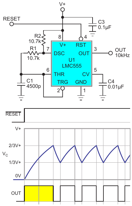

The problem - the first oscillation cycle has a too-long first pulse on start-up, when gated by the RESET pin from oscillation-off to oscillation-on

Figure 1. The problem - the first oscillation cycle has a too-long first pulse on start-up, when gated by the RESET pin from oscillation-off to oscillation-on
Figure 2. The fix via C2 charge injection on oscillation startup to equalize pulse length
Figure 3. The long first-pulse problem also occurs in a 50:50 square wave topology popular for CMOS 555s
Figure 4. C2 charge injection fix applied to CMOS 50:50 square wave oscillator
Figure 5. Bipolar 555 in gated 50:50 square wave configuration
Figure 6. C2 charge injection first-pulse fix modified for bipolar 555 square wave generation
