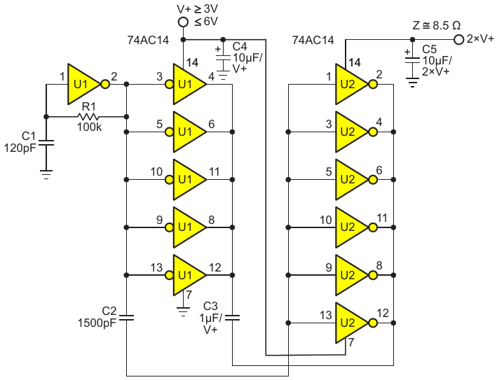

Complete voltage doubler: 100 kHz pump clock set by R1C1, Schmidt trigger, driver (U1), and commutator (U2)

Efficient voltage doubler is made from generic CMOS inverters

Figure 1. Simplified schema of typical basic CMOS gate I/O circuitry showing clamping diodes and complementary FET switch pair
Figure 2. Simplified voltage doubler, showing driver device (U1), commutation device (U2), and coupling (C

Figure 3. Complete voltage doubler: 100 kHz pump clock set by R1C1, Schmidt trigger, driver (U1), and commutator (U2)
Figure 4. Adding four inexpensive parts suffices to triple the supply voltage
