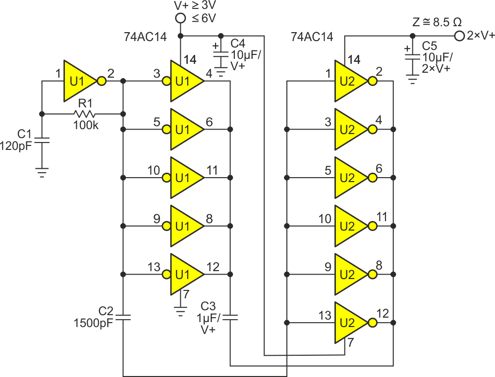

So much for theory. Translation of Figure 2 into a complete voltage doubler is shown in Figure 3.
A 100 kHz pump clock is output on pin 2 of 74AC14 Schmidt trigger U1. This signal is routed to the five remaining gates of U1 and (via coupling cap C2) the six gates of U2. Positive charge transfer occurs through C3 into U2 and from there accumulates on filter cap C5.
Even though Schmidt hysteresis isn’t really needed for U2, another AC14 was chosen for it in pursuit of matched switching delay times, thus improving efficiency-promoting synchronicity of charge transfer.
Some performance spec’s (V+ = 5 V) are:
  • Impedance of 10 V output: 8.5 Ω
  • Maximum continuous load: 50 mA
  • Efficiency at 50 mA load: 92%
  • Efficiency at 25 mA load: 95%
  • Unloaded power consumption: 440 µW
  • Startup time < 1 millisecond

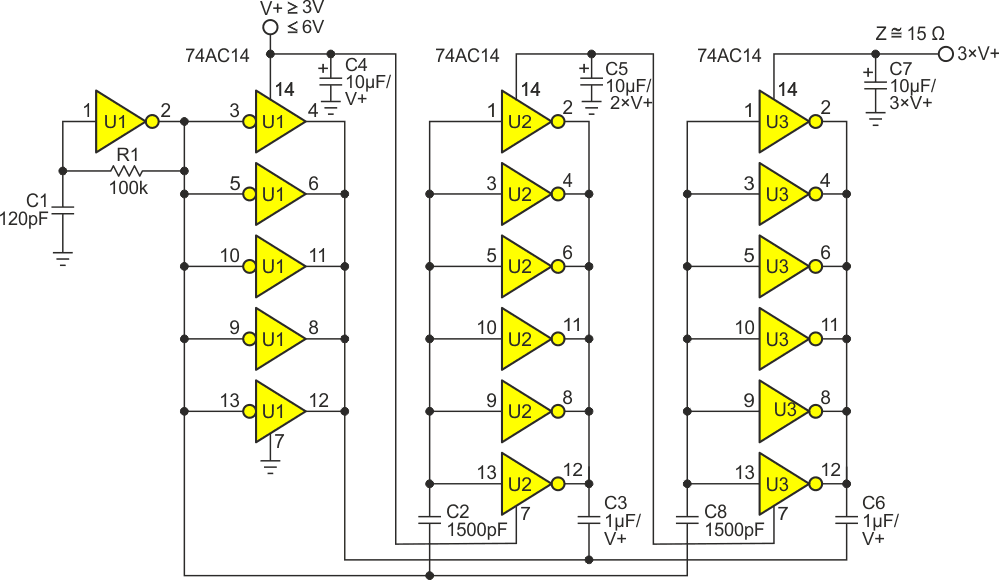

Adding four inexpensive parts suffices to triple the supply voltage.
Figure 4. Adding four inexpensive parts suffices to triple the supply voltage.
So, what happens if merely doubling V+ isn’t enough? As Figure 4 illustrates, this design can be easily cascaded to make an efficient voltage tripler. Extension to even higher multiples is also possible.
