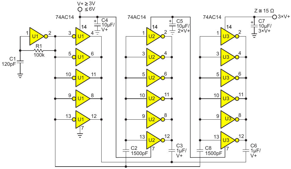

Adding four inexpensive parts …
Adding four inexpensive parts suffices to triple the supply voltage

Efficient voltage doubler is made from generic CMOS inverters
Figure 4
Figure 1. Simplified schema of typical basic CMOS gate I/O circuitry showing clamping diodes and complementary FET switch pair
Figure 2. Simplified voltage doubler, showing driver device (U1), commutation device (U2), and coupling (C

Figure 3. Complete voltage doubler: 100 kHz pump clock set by R1C1, Schmidt trigger, driver (U1), and commutator (U2)
Figure 4. Adding four inexpensive parts suffices to triple the supply voltage
