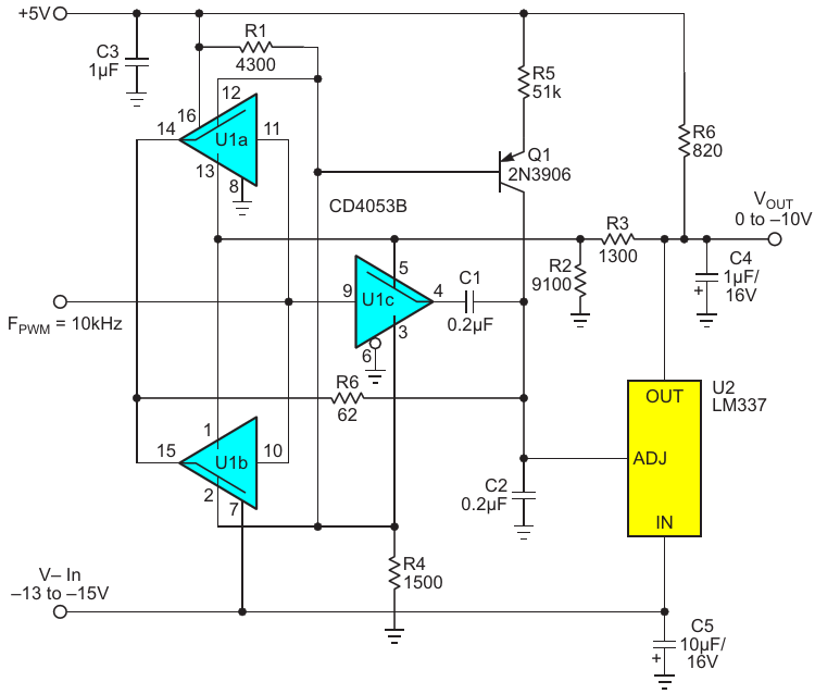

LM337 joins forces with 4053 CMOS switch to make a macho PWM DAC
Stephen Woodward
0 V to -10 V, 1.5 A LM337 PWM power DAC
Figure 1
17 Kb
Figure 1. LM337 joins forces with 4053 CMOS switch to make a macho PWM DAC
Figure 2. Graph of V
OUT
(0 V to -10 V) versus the PWM duty factor (0 to 1). [V
OUT
= -1.25×D/(1 - 0.875×D)]
Figure 3. Graph of the PWM duty factor (0 to 1) versus V
OUT
(0 V to -10 V). [PWM D = V
OUT
/(0.875×V
OUT
- 1.25)]
