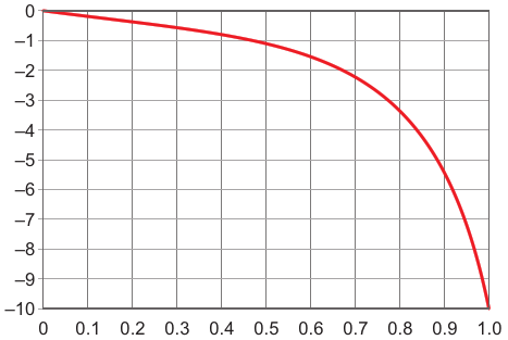

Graph of V
OUT
(0 V to -10 V) versus the PWM duty factor (0 to 1). [V
OUT
= -1.25×D/(1 - 0.875×D)]

Figure 2. Graph of V
OUT
OUT
