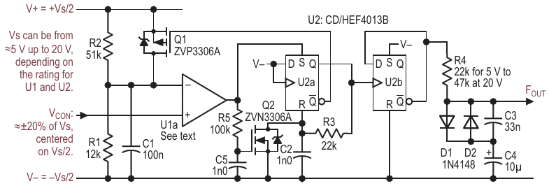

A variant on Part 1's Figure 2, allowing operation with a supply of up to 20 V

A pitch-linear VCO. Part 2 - Taking it further
Figure 1
21 Kb
Figure 1. A variant on Part 1's Figure 2, allowing operation with a supply of up to 20 V
Figure 2. This all-discrete version (apart from the op-amps) uses a second section to produce an output having a duty cycle close to 50%
