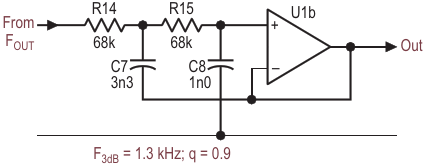

A suitable output filter …
A suitable output filter for adding to Figure 3, and the resulting spectrum

Figure 5. A suitable output filter for adding to Figure 3, and the resulting spectrum
