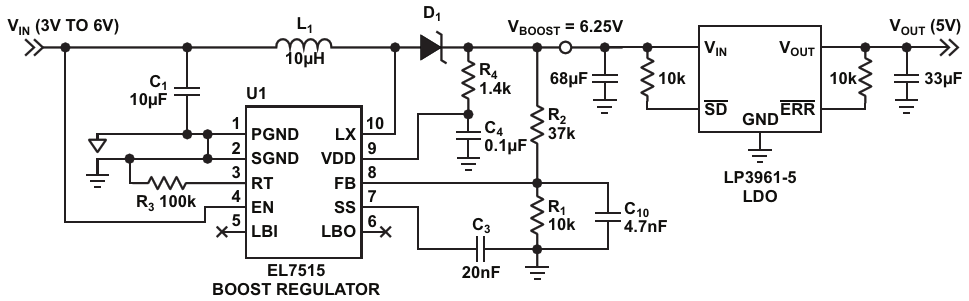

Typical 5 V regulation …
Typical 5 V regulation with boost converter and LDO

A novel approach to creating a high-efficiency, simple buck-boost converter
Figure 1
18 Kb
Figure 1. Typical 5 V regulation with boost converter and LDO
