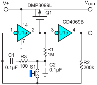

Flip ON flop OFF without a flip/flop
Figure 1. Flip/flop-free debounced push ON push OFF toggling with power-on reset and low parts count
Figure 2. Power up turn off where the rising edge of V+ at PFET a's source with its gate held low by RCs turns it on
