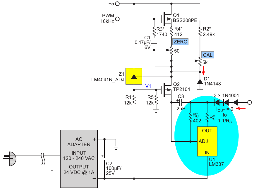

Modifications to facilitate wiping …
Modifications to facilitate wiping out component tolerances including those of U

A negative current source with PWM input and LM337 output
Figure 4
18 Kb
Figure 1. Classic LM337 constant negative current source where I
OUT
≈ V
ADJ
/R
S
= 1.25/R
S
Figure 2. R
C
typically >100R
S
, therefore I
C
< I
OUT
/100 and I
OUT
≈ -(1.25 - (I
C
R
C
))/R
S
Figure 3. An 18 V, 1 A, PWM-programmed grounded load negative current source with a novel LM337 topology. With this topology, accuracy is insensitive to supply rail tolerance. The asterisked resistors are 1% or better and R
S
= 1.25 Ω
Figure 4. Modifications to facilitate wiping out component tolerances including those of U
1
and Z
1
references and all resistors. Note that R
S
= 1.1 ohm
