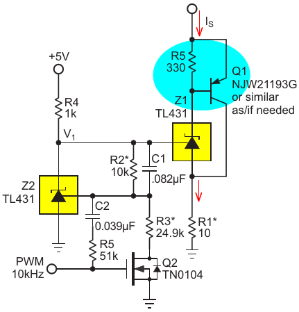

The addition of R5 …
The addition of R5 and C2 provides faster settling times with a 2nd-order ripple filter

Figure 5. The addition of R5 and C2 provides faster settling times with a 2nd-order ripple filter
