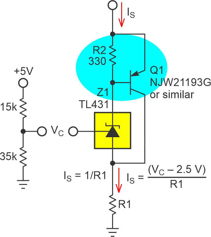

| Figure 2. | Booster transistor Q1 can handle current and voltage beyond 431 max IC and dissipation limits, while the 3.5-V voltage divider programs a constant IS. |
Figure 2 illustrates how a fixed voltage divider might be used (assuming a 5-V rail that’s accurate enough) to use a floated-anode Z1 to regulate a constant sink current of:
It also illustrates adding a booster transistor Q1 to accommodate applications needing current or power beyond Z1’s modest TO92ish limits. Notice that Z1’s accuracy will be unimpaired because whatever fraction of IS that Q1 causes to bypass Z1 is summed back in before passing through R1.

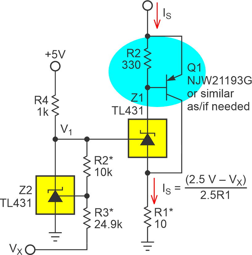

| Figure 3. | DAC control of IS, the DAC signal is inverted, while Z2 provides the necessary level shift. |
Figure 3 shows how IS might be digitally programmed with a 2.5-V DAC signal. Note the DAC signal is inverted (IS = max when VX = 0) while Z2 provides the necessary level shift:
as VX = 2.5 V to 0.

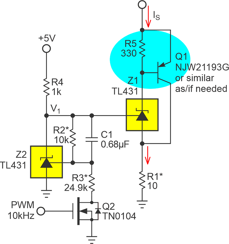

| Figure 4. | PWM control of IS, where IS is the ratio of the PWM duty factor and R1. |
Figure 4 shows an alternate programming method using PWM with IS = D/R1 where D equals the 0 to 1 (0% to 100%) PWM duty factor:
as D = 0 to 1
The 8-bit PWM resolution and 10-kHz frequency are assumed. The R2C1 single-pole ripple filter has a time constant of approximately 64x the PWM period (10 kHz = 100 µs assumed) for 1-lsb peak-to-peak max ripple and 38-ms max settling time.

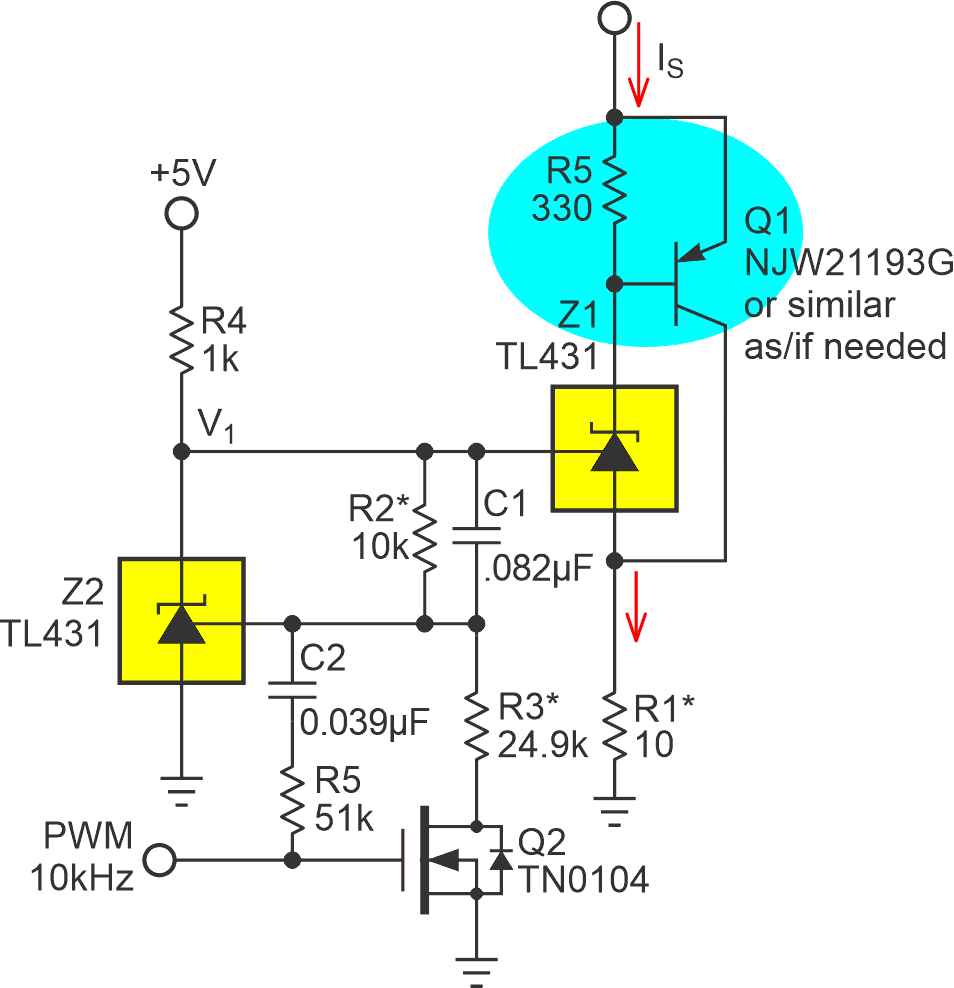

Speeding up settling time
One shortcoming of Figure 4 is the long settling time (~40 ms to 8 bits) imposed by the single-pole R1C12 ripple filter. If an extra resistor and capacitor won’t break the bank, that can be sped up by a factor of about 5 (~8 ms) with Figure 5’s R5C2 providing 2nd-order analog-subtraction filtration (Ref. 1).
| Figure 5. | The addition of R5 and C2 provides faster settling times with a 2nd-order ripple filter. |
