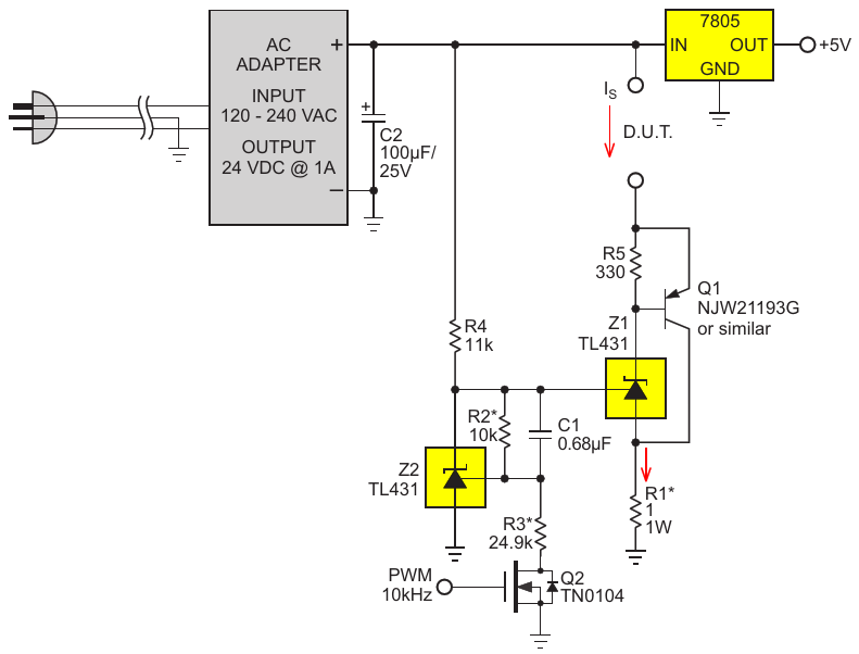

The combined current sink …
The combined current sink and small system power supply where the max I
S
is 1 A, Max V
S
is 20 V, and I
S
= D

Figure 6. The combined current sink and small system power supply where the max I
S
is 1 A, Max V
S
is 20 V, and I
S
= D
