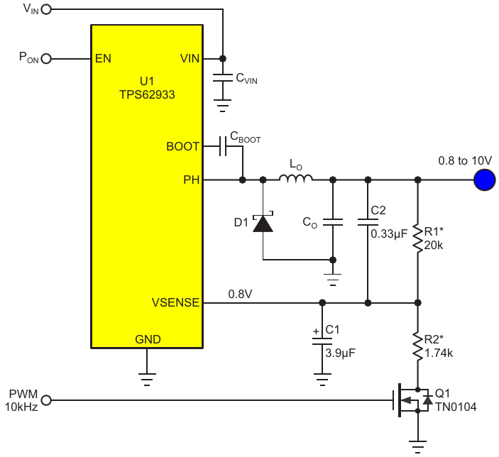

Revisited: Three discretes suffice to interface PWM to switching regulators
Figure 1. A typical regulator output programming network where the V
SENSE
feedback node and values for R1 varies from type to type
Figure 2. Three parts comprise a circuit for linear regulator programming with PWM
Figure 3. Add R3 and C3 to get analog ripple subtraction (Ref. 1), second-order filtering, and a 7-ms settling time. The symbol "*" represents a precision of 1% or better
