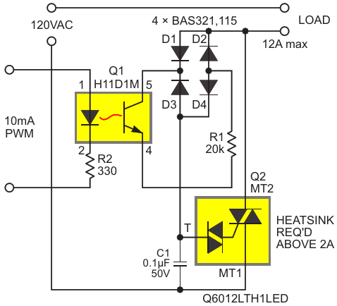

The quadrac Q2 conduction-angle …
The quadrac Q2 conduction-angle triggering time constant = R1C1/D, where D is the PWM duty factor from 0 to 100%

PWM + quadrac = pure power play
Figure 1. The quadrac Q2 conduction-angle triggering time constant = R1C1/D, where D is the PWM duty factor from 0 to 100%
Figure 2. The (V

power output versus the PWM D. The right axis is the voltage of the trigger capacitor (C1), the left axis is the fraction of the full output power versus trigger phase, and the x-axis is the AC phase in radians
