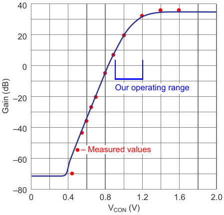

The TDA7052A's control voltage …
The TDA7052A's control voltage versus its gain, with the theoretical curve and practical readings

Figure 1. The TDA7052A's control voltage versus its gain, with the theoretical curve and practical readings
