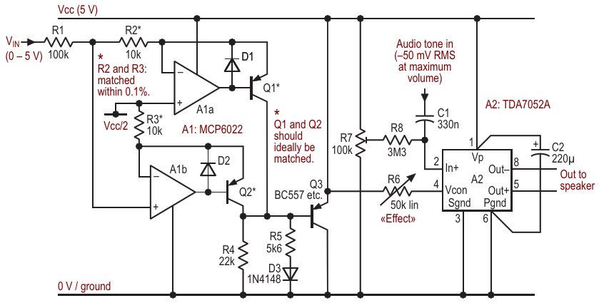

Schematic of a power amplifier that is amplitude-modulated using the dual current source

Figure 3. Schematic of a power amplifier that is amplitude-modulated using the dual current source
