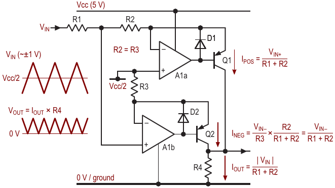

A pair of current sources can make a novel full-wave rectifier

Figure 2. A pair of current sources can make a novel full-wave rectifier
