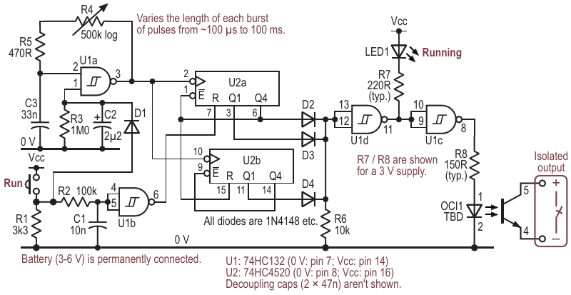

This contact-bounce simulator generates brief bursts of pulses when the Run button is either pressed or released, the burst durations ranging from about 100 µs to 100 ms. The optocoupler provides an isolated output that can pull up or down as needed
AuthorsNick Cornford
Main DocumentArticle «Fake contacts, bounced to order»
DescriptionFigure 1
File Format / SizePDF / 27 Kb
This contact-bounce simulator generates brief bursts of pulses when the Run button is either pressed or released, the burst durations ranging from about 100 µs to 100 ms The optocoupler provides an isolated output that can pull up or down as needed
