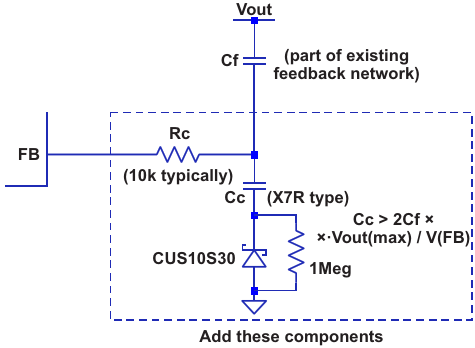

Add these components to protect the FB pin from output rapid negative voltage changes

Figure 3. Add these components to protect the FB pin from output rapid negative voltage changes
