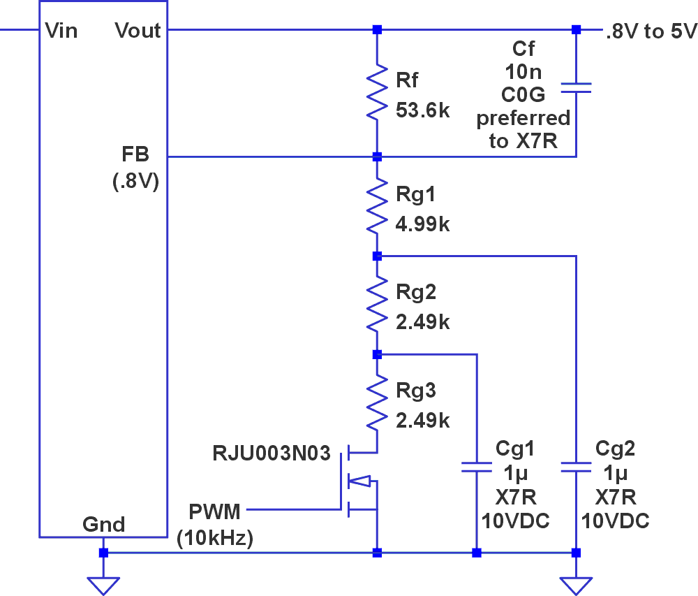

Modifying this structure to incorporate PWM control of the output voltage requires some thought, and both Stephen Woodward and I have presented several Design Ideas (DIs) that address this.
I’ve suggested disconnecting RG from ground and driving it from a heavily filtered (op-amp-based) PWM signal supplied by a 74xx04-type logic inverter. Although this can result in excellent ripple suppression, it has a disadvantage – the need for an inverter power supply, which does not degrade the accuracy of the regulator’s 1% or better reference voltage.
Stephen has proposed switching the disconnected RG leg between ground and open with a MOSFET. The beauty of this is that no new reference is needed. Although the output voltage is no longer a linear function of the PWM duty cycle, a simple software-based lookup table renders this a mere inconvenience. (Yup, “we can fix it in software!”)

Circuit
With this in mind, consider the circuit of Figure 2, capable of operation from 0.8 V to a little more than 5 V.
A specific instance of a PWM-controlled regulator with ripple suppression. Only a linear regulator is shown, but the adaptation for switcher operation entails only the addition of an inductor and a filter capacitor.
Figure 2. A specific instance of a PWM-controlled regulator with ripple suppression.
Note: If the regulator output is capable of operation below the FB voltage, a resistor could be connected between FB and a higher DC supply voltage to enable this. For outputs of 0 V, the current through it would have to equal VFB/RF. The value of RF would have to be increased to maintain operation to 5 V. However, this approach requires a reference voltage of suitable quality, and much of the advantage of using a MOSFET is lost.
The low capacitance MOSFET has a maximum on-resistance of under 2 Ω at a VGS of 2.5 V or more. CG1 and CG2 see maximum DC voltages of 0.8 V (up to 1.25 V in some regulators). Their capacitive accuracies are not critical, and at these low voltages, they barely budge when 10-V or higher-rated X7R capacitors are employed.
CF can see a significant DC voltage, however. Here, you might get away with an X7R, but a 10-nF (voltage-insensitive) C0G is cheap. The value of CF was chosen to aid in ripple management. If it were not present, the ripple would be larger and proportional to the value of RF. With a 10-nF CF, larger values of RF for higher output voltages would have no effect on the PWM-induced ripple; smaller ones could only reduce it. The largest peak-to-peak ripple occurs at duty cycles from 30 to 40%.
The filtering supplied by the three capacitors produces a sinusoidal ripple waveform of amplitude 5.7 µV peak-to-peak. For a 16-bit ADC with a full scale of 5 V, the peak-to-peak amplitude is less than 1 LSbit.
Flexibility
You might have a requirement for a wider or narrower range of output voltages. Feel free to modify RF accordingly without a penalty in ripple amplitude.
Ripple amplitude will scale in proportion to the regulator’s reference voltage. The design assumes a regulator whose optimum FB-to-ground resistance is 10 kΩ. If it’s necessary to change this for the regulator of your choice, scale the three RG resistors by the same factor Z. Because the resistors and three capacitors implement a 3rd order filter, the ripple will scale in accordance with Z–3. To keep the same ripple amplitude, scale the three capacitors by 1/Z. You might want to scale the capacitors’ values for some other reason, even if the resistors are unchanged.
Changing the PWM frequency by a factor F will change the ripple amplitude by a factor of F–3. But too high a frequency could encounter accuracy problems due to the parasitic capacitances and unequal turn-on/turn-off times of the MOSFET.
Some regulators might not tolerate a CF of a value large enough to aid in ripple suppression. Usually, these will tolerate a resistor RCF in series with CF. In such cases, ripple will be increased by a factor K equal to the square root of (1 + RCF × 2π × FPWM × CF), and the waveform might no longer be sinusoidal. But increasing CG1 and CG2 by the square root of K will compensate to yield approximately the same suppression as offered by the design with RCF equal to 0. If all else fails, there is always the possibility of adding an RG4 and a CG3 to provide another stage of filtering.

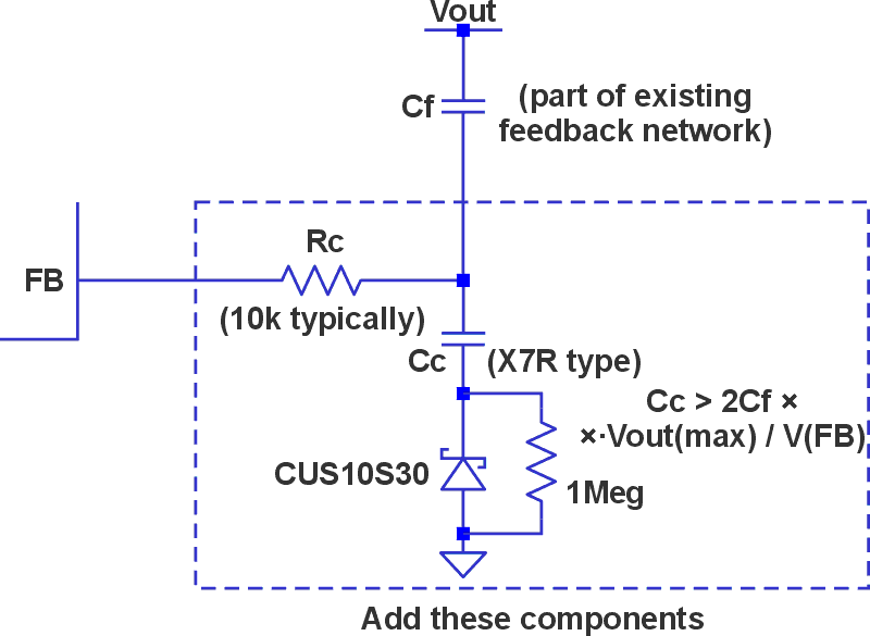

Once again, the Comments section of DIs has shown its worth. And it’s Deja vu all over again; value was provided by the redoubtable Stephen Woodward. In an earlier DI, he pointed out that regulators generally do not tolerate negative voltages at their feedback pins. But if there is a capacitor CF of more than a few hundred picofarads connected from the output to this pin, as I have recommended in this DI, and the output is shorted or rapidly discharged, this capacitor could couple a negative voltage to that pin and damage the part. To protect against this, add the components shown in the Figure 3.
Add these components to protect the FB pin from output rapid negative voltage changes.
Figure 3. Add these components to protect the FB pin from output rapid negative
voltage changes.
In normal operation and during startup, the CUS10S30 Schottky diode looks like an open circuit and it, CC, and the 1 MΩ resistor have a negligible effect on circuit operation. CC prevents the flow of diode reverse current, which could otherwise produce output voltage errors. If VOUT transitions to ground rapidly, CC and the diode prevent any negative voltage from appearing at the junction of the capacitors. RC provides a cheap “just in case” limit of the current into the FB pin from that voltage transient if it somehow saw a negative voltage. (Check the maximum FB pin current to ensure that no significant error-inducing voltages develop across RC.) When the circuit has settled, the voltage across CC is discharged, and the circuit is ready to restart normally.
