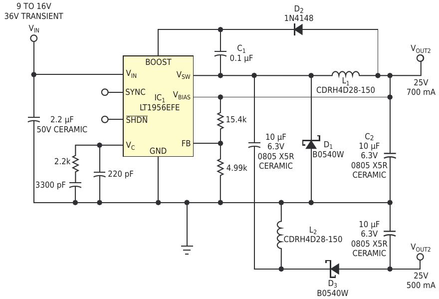

This dual-polarity DC/DC converter …
This dual-polarity DC/DC converter uses a single-switch buck regulator

Buck regulator and two inductors make dual-polarity converter
Figure 1
15 Kb
Figure 1. This dual-polarity DC/DC converter uses a single-switch buck regulator
