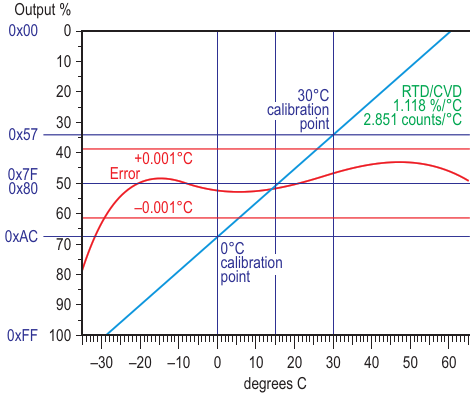

Plotting the output against the RTD's resistance now gives a result that is almost indistinguishable from the straight-line target, the (idealized) error corresponding to much less than 1 millidegree. This shows the performance limit for this circuit; don

Plotting the output against the RTD's resistance now gives a result that is almost indistinguishable from the straight-line target, the (idealized) error corresponding to much less than 1 millidegree This shows the performance limit for this circuit; don
