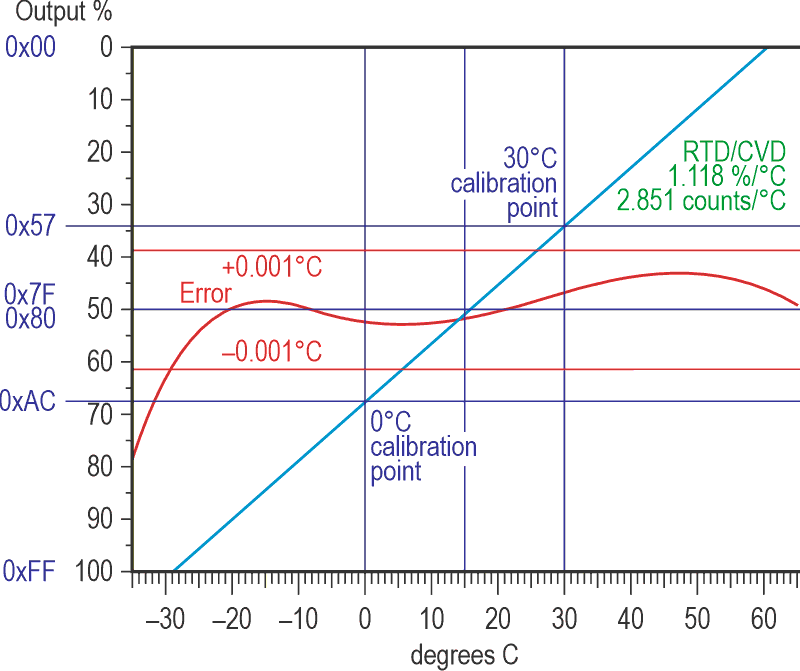

The plot shows the calculated response together with a straight line running through the two actual calibration points of 0 °C (melting, crushed ice) and 30 °C (comparison with a known-good thermometer). That response was calculated using the extended Steinhart-Hart equations rather than the less accurate exponential approximation. Steinhart and Hart (S-H) are to NTC thermistors as Callender and Van Dusen are to platinum resistance temperature detectors (PRTDs), modifying the exponential curve just as Callender-Van Dusen (CVD) tweaks an otherwise straight line.

That straight line, derived from the S-H values at 0 and 30 °C, is the key to this idea. Making the PRTD generate a signal that matches it will avoid any major changes to the processing code, especially the calibration points, and it will also provide a much wider range with greater accuracy than an NTC. Because the voltage from the thermistor circuit is ratiometric, the PRTD must output a level that is a proportion of the supply.

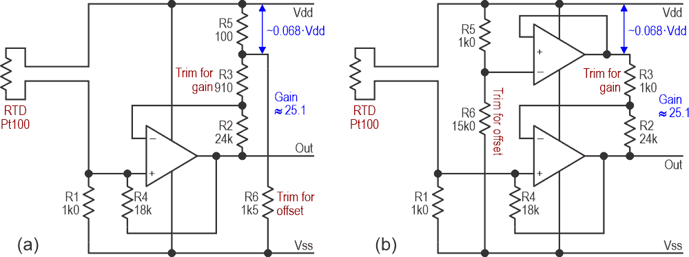

To do that, we amplify the voltage developed across the PRTD, compensate for the CVD departure from linearity, and add an offset. The simplest circuit that can do all these is shown in Figure 2a.
Probably the simplest circuit (2a) that can give an output from a PRTD to match a thermistor's response, with a slightly better variant (2b). These are both flawed, and the component values are not optimized. They are to show the principle, not the practice.
Figure 2. Probably the simplest circuit (2a) that can give an output from a PRTD to match a thermistor’s response, with a slightly better
That simplicity leads to complications, because pretty much every component in Figure 2a interacts with every other one. It’s bad enough to design, even with ideal (simulated) parts, but final calibration could require hours of iterative frustration. Buffering the offset voltage, as shown in Figure 2b, helps, but that extra op-amp can be put to better use.

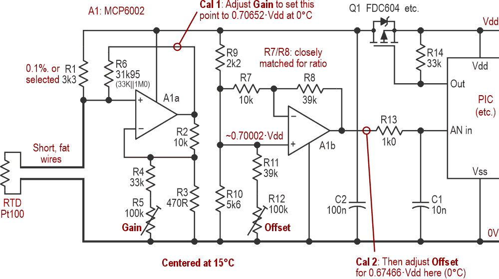

If we split the circuit into two, life becomes easier. Figure 3 shows how.
The final, workable circuit. Amplification and offsetting are now separate, making calibration much easier.
Figure 3. The final, workable circuit. Amplification and offsetting are now separate, making calibration much easier.
The processor turns Q1 on to deliver power. (The previously active-high GPIO pin powering the thermistor must now be active-low to drive Q1’s gate, and that was the only code change needed.) The FDC604 has a low RDS(ON) of a few tens of milliohms, so it drops only 100 µV or so, which is insignificant, even if the measuring ADC’s reference is the Vdd rail. (Offsets within the MCU itself will probably be greater.) Because the circuit is only active for a millisecond every half minute or so, self-heating of the PRTD can be ignored. Consumption was about 3 mA at 5 V or 2 mA at 3.3 V.
R1 feeds current through the RTD, producing a voltage that is amplified by A1a, whose gain can be trimmed by R5. R6 feeds back into the RTD and R1 to compensate for both CVD and the varying drive to the RTD as its resistance changes. Its value is fairly critical: 33k works well enough for our purposes, but 31k95 – 33k||1M0 – is almost perfect, with a predicted error of way under 1 millidegree over a 100 °C span – theoretically – so we’ll use that. Obviously, this is ridiculous overkill with 8-bit output sampling, but if a single extra resistor can eliminate one source of errors, it’s worth going for.
A1b now amplifies the signal further (and inverts it) and applies a trimmable offset. Its output as a fraction of the supply voltage is now directly proportional to the PRTD’s temperature. Note that the gain of this stage is preset: R7 and R8 should be selected so that their ratio is as close as possible to 3.9, though their absolute values are not critical. The result is shown in Figure 4.
Plotting the output against the RTD's resistance now gives a result that is almost indistinguishable from the straight-line target, the (idealized) error corresponding to much less than 1 millidegree. This shows the performance limit for this circuit; don't expect to match it in real life.

A simple program (Python plus Pygame) to plot the circuit’s operation at different scales made it easy to see the effects of changing both R6 and A1a’s gain, with the error curve tilting (gain error) and bending (compensation error). That curve needs to be as straight and flat as possible.
Modeling the first section needed iteration, starting with a (notional) unit voltage feeding R1 and ~0.7 driving R6. Calculating the voltage across the PRTD and amplifying that gave the stage’s output, ready to feed back into R6 for recalculating V_RTD. (Repeating until successive results matched to eight significant figures took no more than ten iterations.) The section representing A1b was trivial: take A1a’s output and multiply by 3.9 while subtracting the offset.

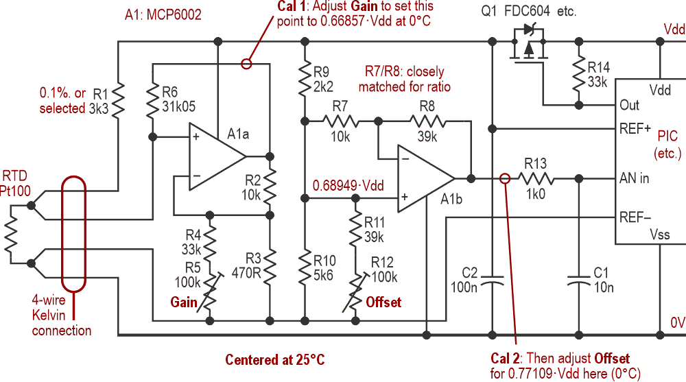

As it stands, the circuit does not lend itself to true 3- or 4-wire compensation for the length of the leads to the RTD – unnecessary with an NTC’s multi-kΩ resistance. However, using a 4-wire Kelvin connection, where the power-feed and sensing lines are separate, should work well and reduce the cable’s effect, as shown in Figure 5. With less than a meter separating the RTD from the circuitry, I used speaker cable. (Copper’s TCR is close to that of a PRTD.)
Figure 5 also shows how accuracy could be improved by driving the ADC’s reference pins from the circuit’s power rails, though this is academic for coarse sampling. It would also compensate for any voltage drop across Q1, should that be important. Q1 could then even be omitted, the circuit being powered directly from an active-high pin. That would drop the rail voltage, which wouldn’t matter if it were fed back to REF+.
Long leads to a PRTD can cause offset errors. Using a 4-wire Kelvin arrangement minimizes these. If the µC's A-D has external reference-voltage pins, they can be driven from the circuit for (notionally) improved accuracy.
Figure 5. Long leads to a PRTD can cause offset errors. Using a 4-wire Kelvin arrangement minimizes these. If the µC’s A–D
This circuit is optimized for a center temperature of 25 °C, as that is the point at which most thermistors are specified, with the load resistor equaling the R(25) value. Unlike the 15°-centered version in Figure 3, I’ve not built or tried it, but believe it to be clean. Its plot – error curve included – looked very close to that in Figure 4, but shifted by 10 °C.
