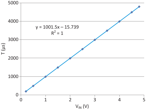

Figure 1. The circuit uses an integrator and a Schmitt trigger with variable hysteresis to convert a DC voltage into a pulse train where the period of the pulses is proportional to the input voltage
Figure 2. The transfer function of the circuit in Figure 1. It is very linear and can be easily adjusted via R
