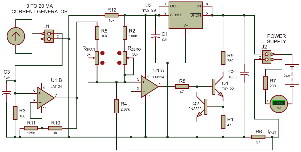

A 0 to 20 mA current source to a 4 to 20 mA loop current converter module circuit. The RSPAN & RZERO potentiometers can be multiturn PCB mountable types for precision adjustment. Q1 should have a heatsink

A 0 to 20 mA current source to a 4 to 20 mA loop current converter module circuit The R sub SPAN /sub  & R sub ZERO /sub  potentiometers can be multiturn PCB mountable types for precision adjustment Q1 should have a heatsink
