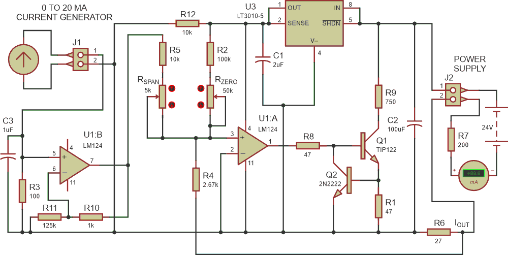

Still, there is equipment, like gas analyzers, which give out a conventional 0 to 20 mA current output. These signals are to be converted into the 4 to 20 mA loop current format to feed the DCS/PLC in the control room.
Figure 1’s circuit does exactly this.
A 0 to 20 mA current source to a 4 to 20 mA loop current converter module circuit. The RSPAN & RZERO potentiometers can be multiturn PCB mountable types for precision adjustment. Q1 should have a heatsink.

How it works
Connect the 24-V power supply, digital ammeter, and a load resistor to J2 as shown in Figure 1.
Then, connect a current generator to the J1 connector. This current flows through R3 and is converted to a voltage.

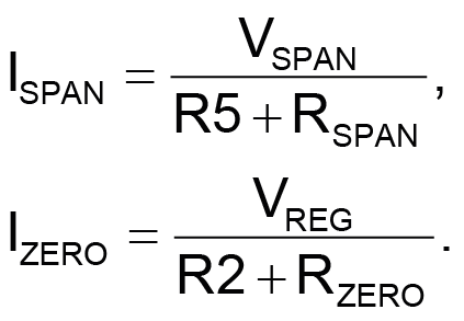

The output of U1B is this voltage multiplied by (1 + (R10/R11)), which is nearly one. Let us call this VSPAN. The output of U3 is VREG.

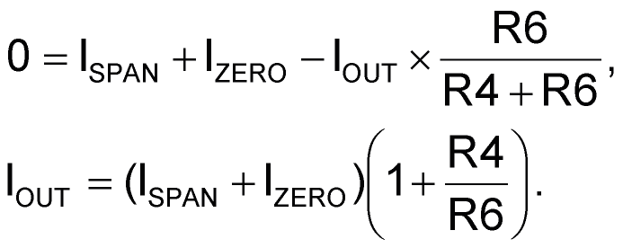

There are three currents at pin3 of U1A. Let us analyze the basic equation of this circuit:

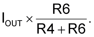

The third current through R4 is:
The total current at pin3 of U1A is:
In this circuit, R4/R6 is chosen to be 99; therefore:
Both U1A and Q1 adjust the current flow through R6, satisfying the above equation in closed-loop control. U3 generates 5 VDC from the 24 VDC input for circuit operation.
R12 loads the regulator to draw a small current. Q2 and R1 limit the output current to around 26 mA.

  • Connect a 24 VDC power supply to J2, a load resistor of 200 Ω, and a digital ammeter to J2 as shown in Figure 1. Connect a current generator to J1 as shown.
  • Keep the current as zero. Adjust RZERO until IOUT reaches 4 mA.
  • Now, set the current generator to 20 mA. Adjust RSPAN until IOUT shows 20 mA.
  • Repeat this a few times to get the correct values. Now this current converter is calibrated.

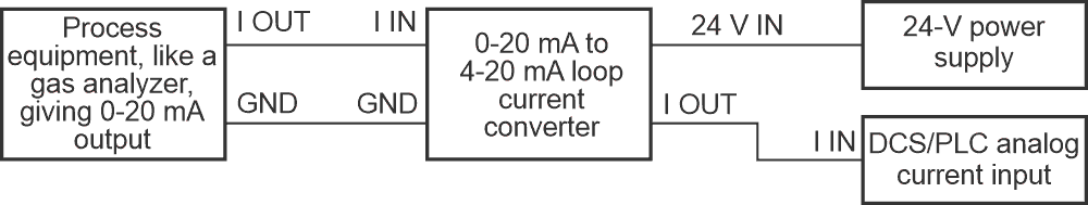

Figure 2 illustrates how this current converter module is connected between the field transmitter and the control room’s DCS/PLC. Make sure to introduce a suitable surge suppressor in the line going to the field.
A block diagram that shows the connection of the current converter in process industries.
Figure 2. A block diagram that shows the connection of the current converter in process industries.
This module does not need a separate power supply. This can be kept in the field near the equipment giving out 0 to 20 mA.
