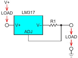

Accurate, robust, fast acting, …
Accurate, robust, fast acting, self-resetting, fault current limiter where Ilimit = 1.25/R1

Figure 1. SCR positive feedback loop suggests an unlikely basis for a BJT current source
Figure 2. Q1 and Q3 current mirror, regulator Z1, and BJT Q1 comprise precision 2-wire current source. The source current is 1.05·1.24/R1, or 1.30/R1. * = 0.1% precision resistor
Figure 3. Accurate, robust, fast acting, self-resetting, fault current limiter where Ilimit = 1.25/R1
