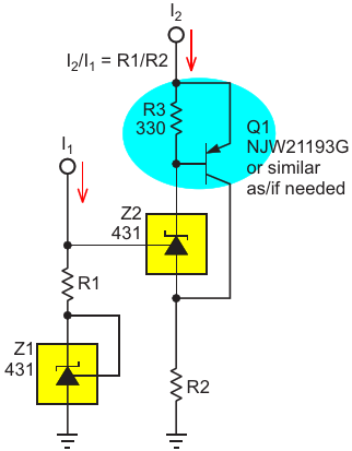

Combine two TL431 regulators to make versatile current mirror
Figure 1. The R1/R2 resistance ratio sets the I
2
/I
1
current ratio
Figure 2. Booster transistor Q1 can handle current and power beyond 431 max IC and dissipation limits
Figure 3. Add six resistors and one transistor to two TL431s to make this 0/20 mA to 4/20 mA current loop converter. Z2 sums the 500-mV offset provided by Z1 with the 0 to 2 V made by current sensor R1, then scales that with R2 to output the 4 to 20 mA with a boost
