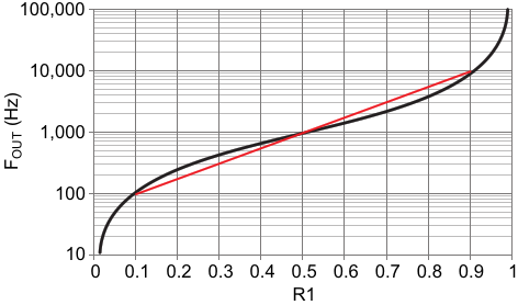

Reasonably good log conformity …
Reasonably good log conformity is seen over mid-80% of R1's travel

Figure 3. Reasonably good log conformity is seen over mid-80% of R1's travel
