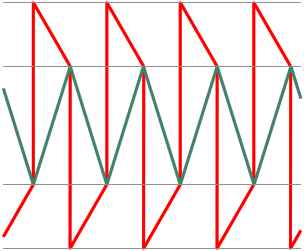

The signal at the …
The signal at the A2+ (red) and A2- (green) inputs

Figure 2. The signal at the A2+ (red) and A2- (green) inputs
