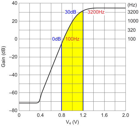

VC's 0 to 2 V antilog gain control span programs A1 pin 4 from 0.8 V to 1.2 V for 1x to 32x gain and FOSC = 100 HzA1gain = 100 Hz(5.66Vc) = 100 to 3200 Hz

V sub C /sub 's 0 to 2 V antilog gain control span programs A1 pin 4 from 0.8 V to 1.2 V for 1x to 32x gain and F sub OSC /sub  = 100 HzA1gain = 100 Hz(5.66Vc) = 100 to 3200 Hz
