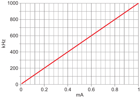

1 MHz 555 VFC
Figure 1. Starred components are precision, including the +5 V supply, but something's missing
Figure 2. Nonlinear red curve versus ideal black shows ~20% linearity error from LMC555 internal delays
Figure 3. R4C2 = T
D
= 212 ns = nonlinearity compensation for 555 internal delays
Figure 4. Nonlinearity disappears if R4 = T
D
/C2 = 212 нс/300 пФ = 706 Ом
