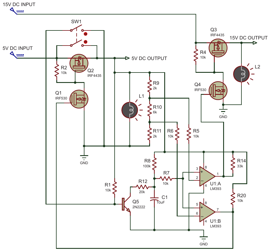

A simple analog circuit …
A simple analog circuit controls the powerup and shutdown sequencing of two power supplies
Jayapal Ramalingam
Single switch controls sequential operation of multiple power supplies
Figure 1
19 Kb
Figure 1. A simple analog circuit controls the powerup and shutdown sequencing of two power supplies
Figure 2. An analog circuit derived from the previous one controls the powerup and shutdown sequencing of three power supplies, with the concept further as-needed expandable
