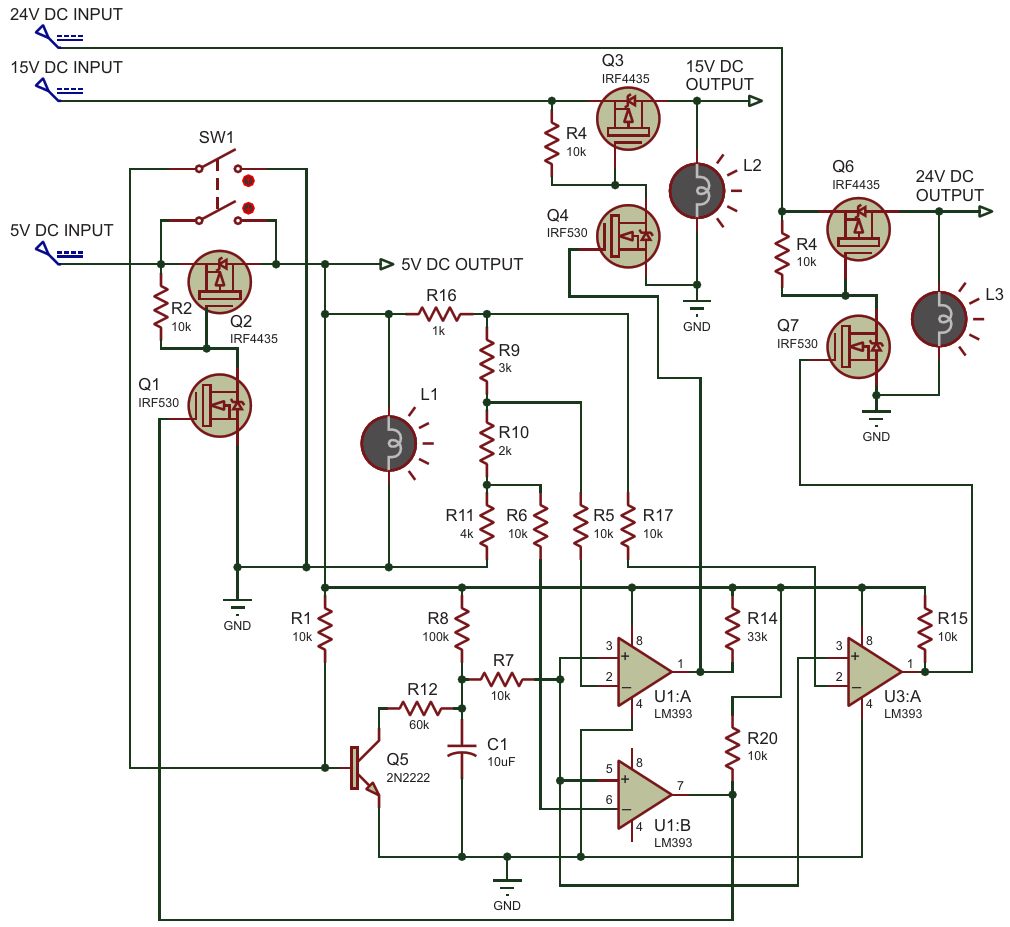

An analog circuit derived from the previous one controls the powerup and shutdown sequencing of three power supplies, with the concept further as-needed expandable
AuthorsJayapal Ramalingam
Main DocumentArticle «Single switch controls sequential operation of multiple power supplies»
DescriptionFigure 2
File Format / SizePDF / 22 Kb
