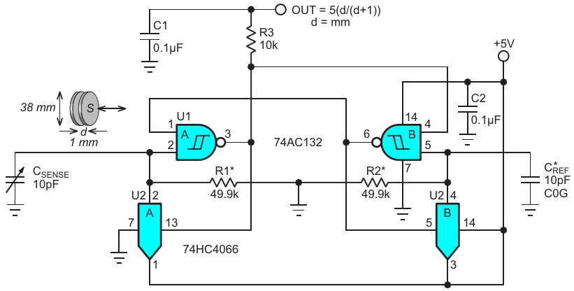

Capacitive position sensor with linearized output

Figure 1. The U1a and U1b cross-coupled Schmidt trigger timers form a ~1 MHz RC multivibrator. The T
SENSE
pulse width is inversely proportional to sensor displacement
Figure 2. Passive RC averaging of the T
SENSE
output yields the analog position output
