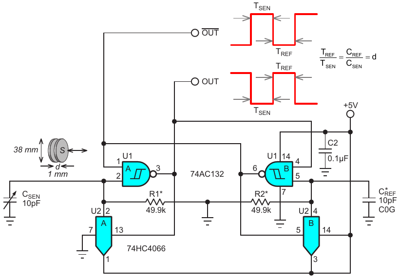

U1a and U1b cross-coupled …
U1a and U1b cross-coupled Schmidt trigger timers form a ~1 MHz RC multivibrator. The T
SEN
pulse width is inversely proportional to sensor displacement

Figure 1. U1a and U1b cross-coupled Schmidt trigger timers form a ~1 MHz RC multivibrator. The T
SEN
