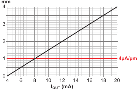

In this graph, black …
In this graph, black = sensor readout d in mm, and red = the nicely constant 4 microamps per micrometer resolution

Figure 4. In this graph, black = sensor readout d in mm, and red = the nicely constant 4 microamps per micrometer resolution
