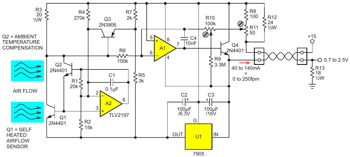

This circuit implements a phantom-powered Darlington anemometer with a 40-140 mA current mode output. Adjust R10 to calibrate 40 mA (zero fpm), and R11 to calibrate 140 mA (250 fpm). The adjustments interact so some iteration may be necessary. Sorry 'bout
AuthorsStephen Woodward
Main DocumentArticle «Phantom-powered solid-state linear airflow sensor»
DescriptionFigure 2
File Format / SizePDF / 21 Kb
This circuit implements a phantom-powered Darlington anemometer with a 40-140 mA current mode output Adjust R10 to calibrate 40 mA (zero fpm), and R11 to calibrate 140 mA (250 fpm) The adjustments interact so some iteration may be necessary Sorry 'bout
