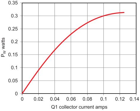

This graph logs Q1 …
This graph logs Q1 power dissipation vs collector current

Figure 3. This graph logs Q1 power dissipation vs collector current
