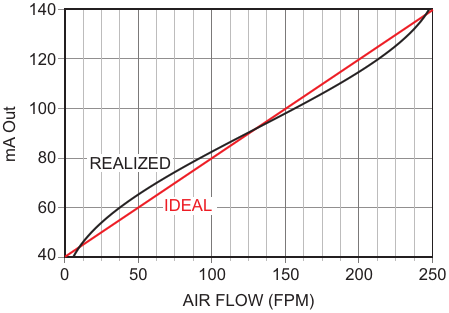

This graph logs anemometer …
This graph logs anemometer output vs airspeed. FPM = 2.5(I
OUT
- 40 mA)

Figure 4. This graph logs anemometer output vs airspeed. FPM = 2.5(I
OUT
- 40 mA)
