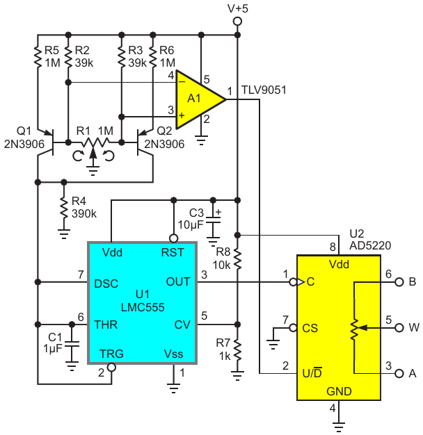

Current-to-frequency converter U1 generates dpot clock pulses at 20 Hz-0-20 Hz, controlled by the sum of Q1+Q2 collector currents set 0 to 5 µA by R1. A1 sets the up/down step direction

Current-to-frequency converter U1 generates dpot clock pulses at 20 Hz-0-20 Hz, controlled by the sum of Q1+Q2 collector currents set 0 to 5 µA by R1 A1 sets the up/down step direction
