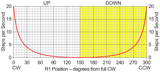

This graph shows the dpot step rate and direction as a function of R1

Figure 2. This graph shows the dpot step rate and direction as a function of R1
